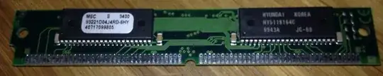

3-This is some RAM I ripped out of an old TV Internet box thingy. It looks like the stuff which was in the computer and fits the RAM slot perfectly, but is it the same? And because I ripped it out of what wasn't a computer should I trust it to have the same pinout and to work safely? enter image description here

  1. Is this TV box RAM the same?
This appears to use the 72-pin SIMM form factor, like your two sticks from the original POS machine. The chip on the right side marked HY5118164C is a 1Mx16 Hyundai CMOS DRAM with 60ns access time and a 1K refresh. Assuming the left-hand chip is the same, I would say this is also 4MB SIMM. As to whether it's parity or not, EDO or not, I can't say.
