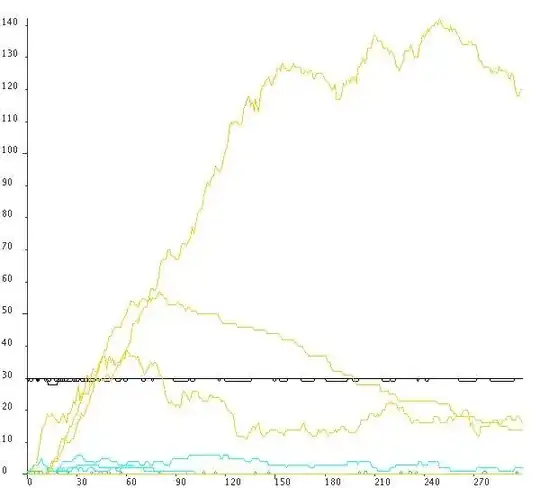

I have an image which looks like this:
Enter image description here
However, the yellow line needs to be red and the cyan line needs to be green. I have Paint and IrfanView. How can I change the colors of the yellow and cyan line without individually selecting all pixels manually?
That is, what is a good way of changing all pixels of one color to another color?

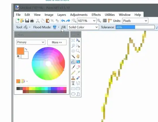

Paint.NET will do it, You just need to do a fill, with 'global' mode instead of contiguous mode.
As per request. I'd note the original was horribly noisy and I cleaned it up a bit. You'd ideally want to clean this up first
There's a few important things here.
Firstly, I was zoomed into the image so I could pick the correct area more easily. There was a ton of anti-aliasing here so I ended up sharpening it (or otherwise cleaning it up), but even then, I went with a fairly high tolerance (The higher the tolerance, the less similar an adjoining pixel needs to be to its neighbours to be recoloured) Play with that value - lower is more 'precise' but you may need a higher value.
Journeyman Geek
  • 127,463
  • 52
  • 260
  • 430
  • Could you please elaborate, step-by-step, for someone who has installed but isn't familiar with Paint.NET? –  Aug 27 '15 at 01:57
    Added a quick gif and explanation. Its pretty simple, assuming you're starting with a clean image. The global vs contiguous option also exists for the magic wand tool, which can be useful, especially if you play around with tolerances. – Journeyman Geek Aug 27 '15 at 12:38

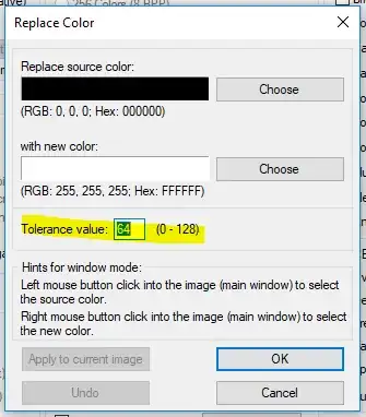

The free (gratis) tool IrfanView has a tool do do this, and it will even do Batch processing (several files, or an entire folder, at once).
Go to File: Batch Conversion, then hit Advanced, then "Replace Color".
Batch Conversion:
screenshot
Advanced:
screenshot
Replace Color:
screenshot
You can select a tolerance (the higher the number, the looser the match).
whiskeychief
  • 238
    Best answer since the OP has IrfanView already installed. I also found the option 'Replace Color...' under the Image submenu. – FreddyFlares Apr 12 '20 at 04:03
