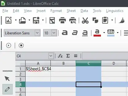

Now, right-click on the tab of the current sheet and choose Sheet Events. Assign onSelectionChanged to the "Selection changed" event.
Also, create style cfFocusCross with a background color.
Finally, go to Format -> Conditional Formatting -> Manage -> Add.
  • Formula is OR(ROW(A1)=ROWWITHFOCUSCELL();COLUMN(A1)=COLUMNWITHFOCUSCELL())+N($A$1)*0
  • Apply style cfFocusCross
  • Range A1:Z100
spreadsheet with row and column highlighted
