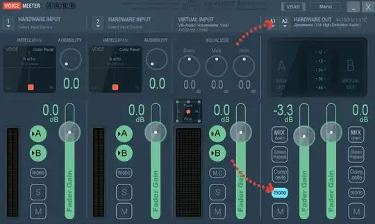

What you need is that program.
http://vb-audio.pagesperso-orange.fr/Voicemeeter/index.htm#DownloadVoicemeeter
Choose your output device at first arrow and set up mono at second.
Jakuje
  • 10,032
  • 34
  • This program is amazing! I have missed this feature since it was removed in Windows 7 and Voicemeeter allows me to force the audio output in mono in software and so much more. – Chaoix Dec 29 '16 at 19:05
