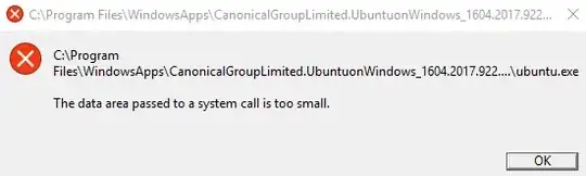

I'm running Windows 10 Insider Preview Build 17074 for PC. The Windows Subsystem for Linux is enabled and I've installed Ubuntu on Windows from the Windows Store.
Whenever I try to launch Ubuntu, it fails with the following error message:
"The data area passed to a system call is too small."
I've tried uninstalling/installing the app (via Apps & features) and disabling/enabling the Linux Subsystem (via Turn Windows features on or off), but still get the same error.
How can I fix this problem?

Error message

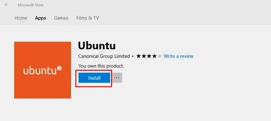

Install Ubuntu

This turned out to be a bug which occurs when SQL Server is running with the filestream feature enabled, as described in this blog post:
Simply speaking, this issue occurs due to due to miscommunication between two filter drivers, namely WCNFS (the desktop bridge) and RsFxXXXX.sys driver (filestream system driver). RsFx system driver doesn't honor flags being passed by WCNFS driver appropriately, which causes startup failure of any Centennial application with the aforementioned error.
Stopping the SQL Server service let me run Ubuntu.
