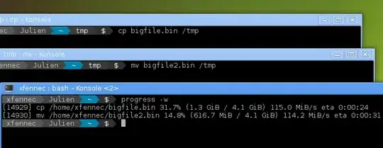

My go-to tool for this kind of stuff is progress:
This tool can be described as a Tiny, Dirty, Linux-and-OSX-Only C command that looks for coreutils basic commands (cp, mv, dd, tar, gzip/gunzip, cat, etc.) currently running on your system and displays the percentage of copied data. It can also show estimated time and throughput, and provides a "top-like" mode (monitoring).
"<code>progress</code> in action" screenshot
It simply scans /proc for interesting commands, and then looks at directories fd and fdinfo to find opened files and seek positions, and reports status for the largest file.
It's very light, and compatible with virtually any command.
I find it particularly useful because:
  • compared to pv in pipe or dcfldd, I don't have to remember to run a different command when I start the operation, I can monitor stuff after the fact;
  • compared to kill -USR1, it works on virtually any command, I don't have to always double-check the manpage to make sure I'm not accidentally killing the copy; also, it's nice that, when invoked without parameters, it shows the progress for any common "data transfer" command currently running, so I don't even have to look up the PID;
  • compared to pv -d, again I don't need to look up the PID.
