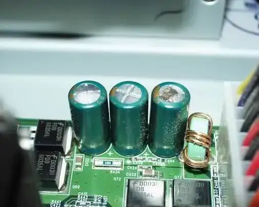

As for the fault itself, the number one cause in older machines is Blown Capacitors, I have attached my little guide:
Blown capacitors -
Blown capacitors can be the cause of many "random" problems which appear to be completly unrelated, very annoying and hard to diagnose.
alt text
The top should be almost flat (with slight indents out embossed sections depending on specification... look at the middle one) but you do not want to see any big bumps such as the first one or any leakage as the last one.
Hope this helps.
