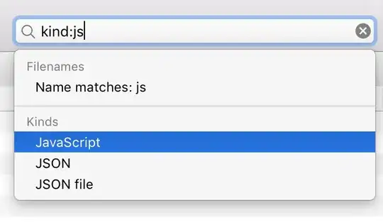

Type kind:js in the Spotlight search field, then specifically choose JavaScript as the kind.
