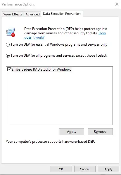

I have just turned on DEP not only for services but for everything:
Data Execution Prevention
It didn't have any effect, just tried it. Leaving it enabled.
