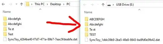

Examples (PC folder name -> USB folder name):
Incorrect:
  • Test -> TEST
  • Abcdefgh -> ABCDEFGH
Correct:
  • Te st -> Te st
  • Abcdefghi -> Abcdefghi

  • @Tyson As for your 2nd question, I did as you suggested and the result is the same. I created a "New Folder" in C:\ and made a folder called "Test" inside it. I re-formatted the USB as FAT32. I created a new SyncToy folder pair with the left folder "C:\New Folder\" and the right folder "E:\". After running the folder pair sync, a folder called "TEST" appeared on the USB drive E:\. I took some screenshots which I will upload to illustrate it better. – RPH Feb 23 '18 at 16:05

The problem lies on the fact that name of a file/directory actually consists of 2 names: The old (short) 8.3 convention and the new (long) 255-character name.
Specifically for FAT file systems, the system updates both these names whenever you give a name to the file. The short name is created automatically, based on the first characters of the long name (e.g. SyncToy_4264be.dat becomes SYNCTOY~1.DAT). If the name fits into the old naming convention, the long name is discarded.
In the old days of DOS, there was no case sensitivity for file names and programs were free to display them however they would like (either all uppercase or all lowercase). Internally, however, they were stored all uppercase.
Based on this, it seems that Windows 10, when it comes to the 8.3 naming case, doesn't preserve character case information when writing to a FAT volume and converts all characters to uppercase.
You can read some details about file naming conventions here: Long File Names
