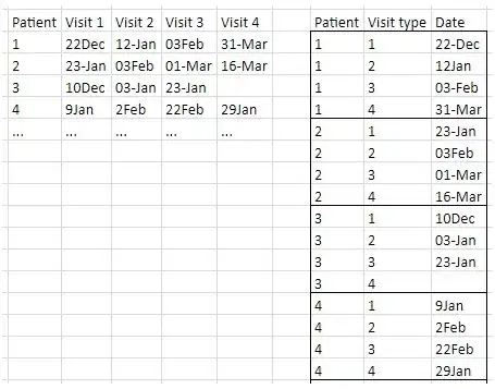

My approach uses a Two Way Lookup technique, just like one of the answers above.
See the pictures below, which show the sample data in the first table, then the list of patients, visit number and date, all in the desired order, in the second table.
Here are the formulas to get the:
Patient list: in Cell A10, =INT((ROW(A1)-1)/5)+1
Visit Type list: in Cell B10, ="Visit"&INT(MOD(ROW(A1)-1,5))+1
Date List in Cell C10, =INDEX($B$2:$F$8,MATCH(A10,A$2:A$8,0),MATCH(B10,$B$1:$F$1,0))
Drag all 3 Formulas down, as far as required.
