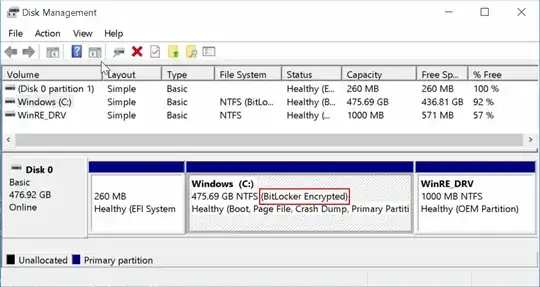

In Disk Management, the partition says "NTFS (BitLocker Encrypted)": enter image description here

Is the drive encrypted with BitLocker or not? Is the activation only for creating a recovery key, or does activation encrypt the partition?

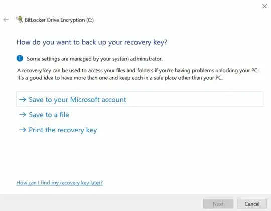

How to Finish Activating BitLocker
There are several ways to activate BitLocker in this situation. I prefer doing so from the Control Panel as it allows you to enable protection without requiring a Microsoft Account:
  1. In Start search manage BitLocker and choose the result from Control Panel
  2. In the BitLocker Drive Encryption applet click Turn on BitLocker
  3. Choose one of the options for backing up your recovery key.
  4. Finish the wizard.
The result of completing this wizard is that your volume encryption key is "protected" and no longer saved to the disk in the clear, meaning your encrypted data is now actually protected from unauthorized access.
