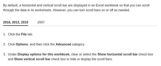

I checked for resolution in the Documentation on Microsoft Support that says this.
But the options are already checked. Can anyone figure out What's the problem ?

1.Click the File tab.
2.Click Options, and then click the Advanced category.
3.Under Display options for this workbook, clear or select the Show horizontal scroll bar check box and Show vertical scroll bar check box to hide or display the scroll bars.
