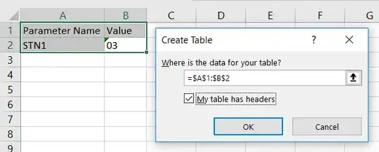

Rajesh S' answer can already satisfy your requirement. However, the weakness on his answer is that your parameter is dependent on its location on the table. I am suggesting a better solution:
  1. Just as Rajesh suggested, create a table with proper headers: Creating Table from Range

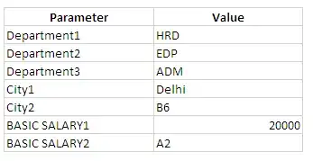

No, directly you can't use the cell reference. What you need to do is to create a separate Data Range and convert it to Table.
Now convert this Range into Table and assign a proper name like ParaTAB or ParameterTAB, then you command should be like this,
let
   Source = Odbc.Query("dsn=AS400", "select * from libm61.emleqpm1 where STN1 =  ParaTAB[Value]{2}  ")
in
    Source
Here Power Query will pick the third value or third row which is ADM, since it counts from 0.
NB: Remember B6 and A2 are cell references.
