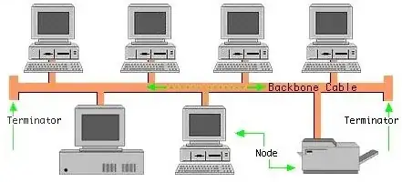

Early in networking, computer networks were built using bus topology. usually called thin or thick-net. (depending on what coax cable was used.) because each end-station was sharing the same wire (bus) and was half duplex, meaning a device could send or receive, but not both simultaneously. Due to this networking design collisions could occur on the wire. (when two devices tried to transmit at the same time.)
bus top
The solution to many devices on one wire was, "Carrier Sense multiple access with collision detection". (CSMA/CD)
