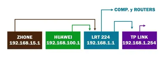

I have 2 ISPs connected to a dual wan Linksys LRT224.
On the LRT224 I configured the failover as shown:
However, failover does not work if WAN1 fails (fiber optic is down), if physically I disconnect the WAN1 cable, WAN2 starts working but I must disconnect the cable to the failover work. Looking at the LRT224 status, I found that WAN2 has not gotten any IP as shown in the pic.

Solution was adding the ISP host and removing other options, my test was made disconnecting the fiber from the router, hope this works in a real word scenario:
