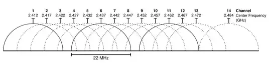

Also, just a general tip when choosing a channel manually, try to find one that is as far from any other used channels as possible. With a few special exceptions like channel 14 in the 2.4 GHz band most channels partially overlap at least one other channel, so being as far from other channels that are in-use as possible will help reduce interference:
2.4 GHz channels
Image source: Wikipedia.
