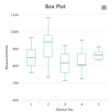

If you just have two or three devices and their data, you could use a Normal distribution or Bell curve to plot your mean and standard deviation. But if you have more devices, I recommend you to use Box Plot. I made a sample for your problem and it looks like this.

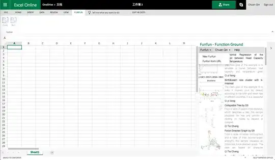

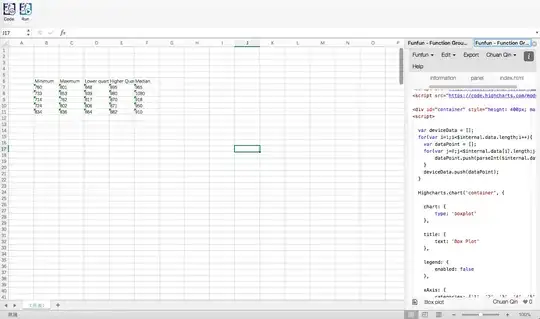

While Excel doesn't have original box plot support, you could draw this kind of chart easily using JavaScript libaries like HightCharts.js that I'm using for this sample. You could use Funfun to write and run JavaScript code in Excel, so that drawing a box plot like this would be easier in Excel. Here is the code that I used in the Funfun Online Editor:
https://www.funfun.io/1/edit/5a364ae474efa7334ff27269
The box plot could give the readers more information about your measurements. But you need to make some modification to your data. In this case, I used quartile and median to reveal the data. So in order to draw this chart, your data should look like this.
           Minimum  Maximum Lower quartile  Higher Quartile Median
 Device1     760      801        848             895         965
 Device2     733      853        939             980         1080
 Device3     714      762        817             870         918
Then, with the code in the link above, you could use FunFun add-in to load the chart directly into your excel using the URL above.
