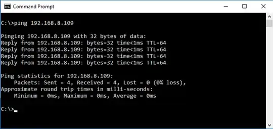

I checked all the firewalls and everything's been turned off. I am actually able to get through to the host machine.
VirtualBox Bridge Adapter ping host
Any idea how I would be able to get traffic through, would be appreciated.
