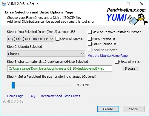

Is there any way to repair the bootloader of existing YUMI drive? I haven’t found any corresponding option in the install window.
install window screenshot

I was able to force YUMI to reinstall the bootloader by renaming the following files in the multiboot folder:
  • libcom32.c32
  • ldlinux.sys (hidden by default)
Then YUMI reinstalled bootloader when installing another ISO using its wizard. The file ldlinux.sys was recreated but libcom32.c32 not, so I had to rename it back. Then I was able to boot my YUMI drive again!
