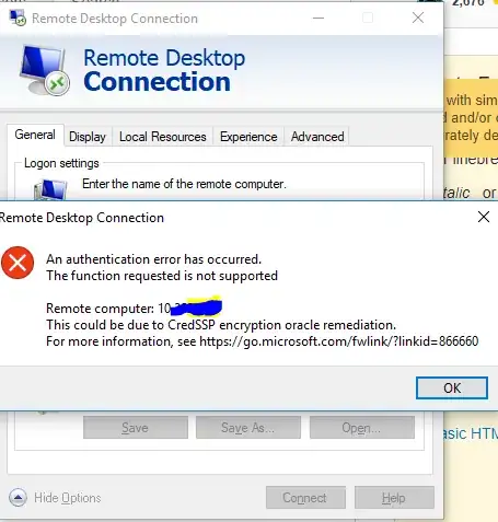

After Windows Update, I get this error when trying to connect to a server using Remote Desktop Connection.
When read the link provided by error message, it seems because of an update at 2018/05/08:
May 8, 2018
An update to change the default setting from Vulnerable to Mitigated.
Related Microsoft Knowledge Base numbers are listed in CVE-2018-0886.
Is there a solution for this?

I found one solution. As described in the help link, I tried roll back from update 2018/05/08 by changing the value of this group policy:
  • Run gpedit.msc
  • Computer Configuration -> Administrative Templates -> System -> Credentials Delegation -> Encryption Oracle Remediation
Change it to Enable and in Protection level, change back to Vulnerable.
I am not sure if it may rollback any risk of an attacker exploiting my connection. I hope Microsoft will fix this soon so I could restore the setting to the recommend setting Mitigated.

As in some answers, the best solution for this error is to update both server and clients to version >= the 2018-05-08 update from Microsoft.
If you cannot update both of them (i.e. you can only update client or server) then you could apply one of the workarounds from the answers below, and change the configuration back ASAP so that you minimise the duration of the vulnerability introduced by the workaround.

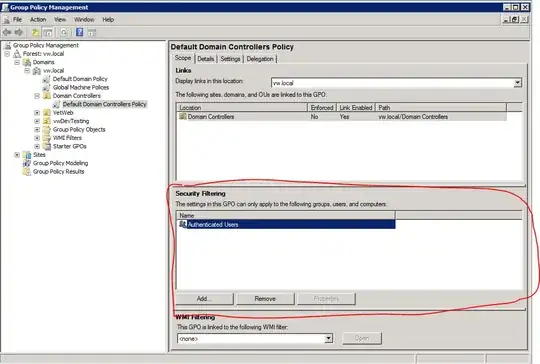

Update on GPO example on print screen.
Based on the answer "reg add "HKLM\Software\Microsoft\Windows\CurrentVersion\Policies\System\CredSSP\Parameters" /f /v AllowEncryptionOracle /t REG_DWORD /d 2"
Print Screen
Key Path: Software\Microsoft\Windows\CurrentVersion\Policies\System\CredSSP\Parameters
Value Name: AllowEncryptionOracle
Value data: 2
