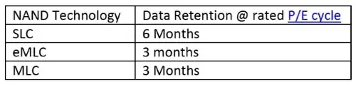

The Dell article of Solid State Drive (SSD) FAQ (PDF) from 2011 states this :
Q: I have unplugged my SSD drive and put it into storage. How long can I expect the drive to retain my data without needing to plug the drive back in?
A: It depends on the how much the flash has been used (P/E cycle used), type of flash, and storage temperature. In MLC and SLC, this can be as low as 3 months and best case can be more than 10 years. The retention is highly dependent on temperature and workload.
imahe
While SSD technology has much evolved since 2011, the above article is still alarming. I note that it does not say that all the data will lost, but only that some data lose may occur after some days, weeks or months.
