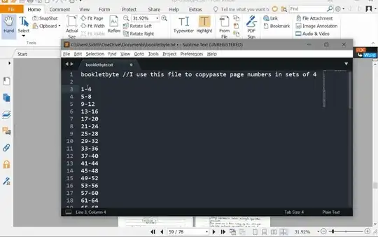

PROBLEM:
  • I have been manually copy-pasting pages in sets of 4
    • i.e. 1-4, 5-8, 9-12..so on, while trying to print pages.
  • I haven't found a way to do this automatically.
    • (If there is a command for this) Say, If I have to print 12 pages, I should be able to just enter 12 and the document-name.pdf to start printing 1-4, 5-8, 9-12..in succession.
GIF for clarification:
Printjob-gif See ^this gif fullscreen
REQUIREMENTS:
  • Printing should be done in booklet form
    • a booklet is 4 pages of document in 1 sheet of paper; two pages in front, two at the back.
CONTEXT:
Printing all pages into a booklet makes a bulky booklet. Cutting and clipping is time consuming. Therefore, I print in sets of 4 pages, so that they can be neatly folded. Currently, I have been manually copy/pasting page numbers. Obviously, this is time-consuming but it still saves me time compared to cutting and clipping. Therefore, I still stick to it.
  • I am fond of using Foxit Reader because it is extremely easy to make booklets with it. So, while making booklets, I've been printing sets of 4 pages manually for a while now. This is because the A4 sheet folds neatly into two, giving me 4 pages of print of a document from a single physical sheet. I don't like to use sets of 8 pages or, above(i.e. all pages at once), because then I cannot fold the pages right in the middle. I could cut the whole stack and clip them together, but it is too much work for regular printing.
To clarify further
Image representation of layout View ^this image in fullscreen
What I tried?
  • I tried sending print commands like 1-4,5-8 but I guess the command is equivalent to 1-8 because that's what I got.
Can this be solved?
I feel like there should be a solution to this simple problem. But is it unsolvable due to some weird quirk? * i.e. the sort of thing that makes "Replace All" in Adobe Acrobat unavailable even in 2018?
Any answer would be appreciated, on that front.
I am using
  • Application: Foxit Reader
  • OS: Windows 10 Pro
  • Printer: Samsung M3320ND (Has it's own booklet mode, but I don't use it*)
    * it messes up with foxit's booklet mode.

    @Seth , hopefully, it is a lot more understandable now. I've included gif and pic. – Siddhant Rimal Jul 12 '18 at 15:35
