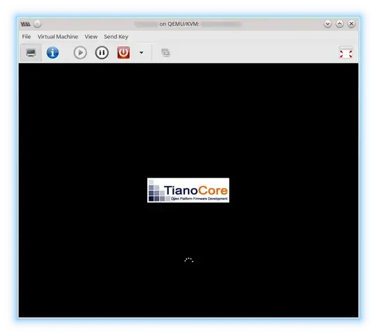

The original issue:
When i try to boot from a current and tested Win10.iso it gives me the BSOD with IRQL_NOT_LESS_OR_EQUAL.
So how can I fix the BSOD?
I see that the error is related to memory allocation, but I have no idea what to change to make it work.
I already had the VM up and running (so it is possible to get around that error), except for the error 43 thing from nVidia, but then i realized that my base system was corrupted, so I decided to do a clean reinstallation, which worked perfectly until the first VM boot up.
Heres the current XML. Its lacking the vfio-drivers.iso and the Bootdrive, because the problem is that the Win10.iso won't boot.

UEFI TianoCore Windows boot
The easiest way to resolve this is to configure the libvirt domain XML how you want it beforehand and then reinstall Windows for that hardware.
