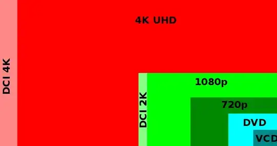

Attie has explained how vertical pixel counts were derived for traditional resolutions such as SD (480p), HD (720p) and Full HD (1080p). I would like to discuss K measurements which originate from the cinema industry. A K is about 1000 horizontal pixels and 2K and 4K were casual terms referring to resolutions of approximately 2000 and 4000 horizontal pixels.
Different K measurements were later standardised for digital cinema (2005) and consumer television (2007).
Digital Cinema Initiatives has specified the DCI 4K and 2K resoultion standards (4096 × 2160 and 2048 × 1080). These are the full frame resolutions for digital cinema projectors, with many films displayed in the a crop format such as flat crop (3996 × 2160 , 1.85∶1 aspect ratio) or CinemaScope crop (4096 × 1716, ≈2.39∶1 aspect ratio).
The 4K standard for consumer television (UHDTV1) can be more accurately labelled as Ultra HD or Quad HD. It is equivalent to 4 Full HD frames placed together. It is 3840 × 2160 with ≈1.78∶1 aspect ratio.
The Wikipedia article on 4K resolution provides a helpful visualisation which compares different frame sizes.
