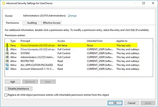

So I had Process Monitor show me what key was affected by the access denied error. Sure enough it pointed out the attempt to write values inside HKEY_CURRENT_USER\Software\Microsoft\Windows\CurrentVersion\Explorer\FileExts\.bmp\UserChoice. So I checked out the permissions on that key and saw nothing suspicious. But on closer inspection in the "Advanced Security Settings" dialog for the UserChoice key I saw this:
Since my days as system administrator at the university Deny ACEs have been a rare sight, though. Now, being acutely aware of ACE precedence rules inside ACLs it immediately dawned on me that this Deny ACE was the issue. It dominated the ACL for my user account.
A tool such as FileTypesMan would have to actively remove that ACE and then put it back after any manipulation. Evidently it doesn't do that (possibly a defect that I should report?). There's no other way I know of, with the possible exception of acquiring and enabling the backup and/or restore privilege (aka user right) - which amounts to sidestepping the ACL and ACEs (aka cheating through the means of an admin ;)).

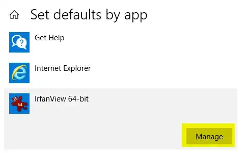

The workaround was as follows. Open the "Windows Settings" app, pick "Apps" and then choose the "Defaults Apps" item on the left hand side. Scroll down in the main pane and from the bottom choose "Set defaults by app".
Default Apps
From there find the application - in my case IrfanView - which you want to manage and hit the "Manage" button (after selecting the program of your choice).
IrfanView in the app list

Although at the beginning I was skeptical about the poster's problem, I am flabbergasted to find this monumental gaff by Microsoft.
All the cases I have examined where the problem didn't occur, were installed before Windows 10 version 1809. When I downloaded the 1809 versions of Windows 10 Enterprise (Business) and Windows 10 Pro (Consumer) and did a clean install in virtual machines, they had this ACL!
This ACL is a new addition and did not exist in prior versions. It is apparently only stored during a clean install, not during the upgrade to 1809 from a prior version. I don't know what brainstorm brought this on, but Microsoft apparently decided to force the use of its Photos app upon the world.
We developers have no other option but to adapt to this new situation. You would need to delete this new and blocking ACL.
If you are looking for a solution in the form of a .reg file that deletes the Set Value entry, I think you will need to delete the entire branch for .bmp and recreate it anew in order to get rid of it. Otherwise, changing permissions would require a script or an installation program.
Something like :
[-HKEY_CURRENT_USER\Software\Microsoft\Windows\CurrentVersion\Explorer\FileExts\.bmp]
[HKEY_CURRENT_USER\Software\Microsoft\Windows\CurrentVersion\Explorer\FileExts\.bmp]
