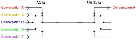

In order to address these issues, you can multiplex the two (or more) streams into one stream... enter the concept of a "Container". In this context, the term is somewhat synonymous with a "Mux" or "Multiplexer".
One could argue that the "multiplexer" is the logical block (code) that deals with splitting or merging the streams, while the "container format" is the way the data is prepared and formatted for storage or transmission.
At a more fundamental electronics level, a multiplexer will simply put one signal on a transmission line at a time.
mux demux graphic
