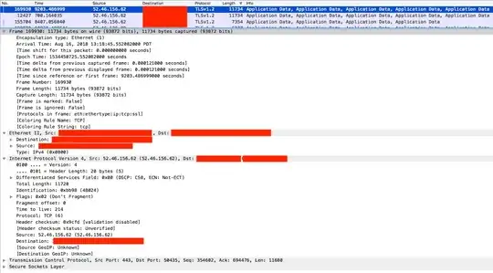

I attach an example of a frame that exceeds the MTU. Note that this frame was captured on the router's WAN interface (eth0). Is this simply a result of TSO/GSO, or is there something else going on that I am not aware of? Also, does TSO/GSO work in both directions, or does it only apply to outbound packets? If the latter is the case, then TSO/GSO cannot be the explanation since the example packet is inbound from the router's point of view.
Update: disabling TSO/GSO on the router's WAN and WLAN interfaces did not change anything; the large frames are still present when re-running the experiment.
Example of frame that exceeds MTU

This is just your router doing LRO (or maybe GRO).
It’s not TSO/GSO because you’re only seeing it on packets received by your router, not ones it is transmitting.
