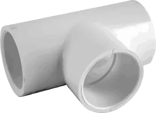

This is a tee:
A T-shaped pipe fitting. It has an inlet, and two separate outlets.
In other words, it splits one pipe into two; like a fork in the road.
Similarly, tee is a pipe (|) that allows you to redirect your standard input to two separate outputs.

    +1 for picture which as we know is worth a thousand words – Sergiy Kolodyazhnyy Sep 14 '18 at 04:57
  • If you had picked a garden hosepipe T piece, you would have been in line with Doug McIlroy's original metaphor. – JdeBP Sep 18 '18 at 16:21
  • @JdeBP Sorry, I have no idea who that is. Is he the original author of the utility or something? The flow of data & physical electrical current are often compared to hydraulic systems, but you probably know that. Anyway, I just chose this style to keep it super simple. I was actually going to do that to keep it familiar, but the garden variety tend to have more of a Y-shape and/or visually complicated attachments for attaching accessories, etc. It's essentially the same though. – voices Sep 19 '18 at 17:34
    M. Douglas McIlroy, author of [this famous memo](https://www.bell-labs.com/usr/dmr/www/mdmpipe.html) who [worked at Bell Labs](https://s3-us-west-2.amazonaws.com/belllabs-microsite-unixhistory/streams.html) and [persuaded Ken Thompson to put pipes into Unix](https://s3-us-west-2.amazonaws.com/belllabs-microsite-unixhistory/sohedid.html). – JdeBP Sep 20 '18 at 12:59
