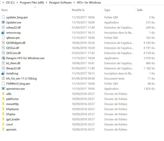

As you asked, there is a service running called apmwinsrv. I tried to uninstall the application from the Programs and Features panel, also with CCleaner running as administrator. I had to stop the service before being able to run the uninstaller but the result is the same, the Paragon HFS+ for Windows entry still in my programs list. When I try to remove it, I have an admin popup asking for a program to be elevated: C:\WINDOWS\Installer\ac2a1a.msi
So when I go to this executable I can try to manually uninstall it with admins rights but I have the same result as before.
Finally, there is a screenshot of the content of the install :
paragon
As you can see there is a reg modifier so I'm afraid that my register was modify. and if I look on all subdirectories, there is nothing talking about an uninstaller.exe

I contacted paragon and they gave me this solution (that worked on my paragon so, GOOD LUCK!)
  1. Launch HFSCleaner-2.exe as Admin, let it perform its task, then reboot PC when prompted.
    • HFSCleaner-2.exe received from Paragon Support
  2. Delete these files from C:\Windows\system32\drivers:
    • apmwin, apmwinsrv, csvol, gpt_loader, mounthlp, hfsplus, hfsplusrec
  3. Install latest HFS4Win
