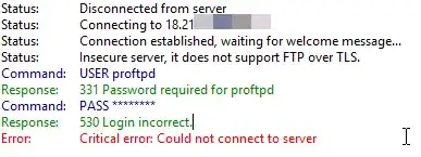

And I get the following error:
incorrect data

  • Why FTP? Do yourself a favour an go with SFTP. If you notice, the log says *Login incorrect*, so I would start from there. Check the logs on the server. Please note that FTP needs data ports as well. – simlev Sep 15 '18 at 20:29

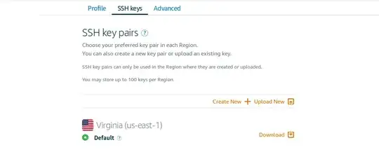

  1. Download SSH Key enter image description here

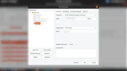

    2.2 Then, Press ctrl+s to open sitemanager, under General tab
     Protocol : SFTP - SSH File Transfer Protocol
     Host : your_lightsail_static_ip
     Logon Type : Interactive
     User : light_sail_provided_user_name
enter image description here That's it done.
