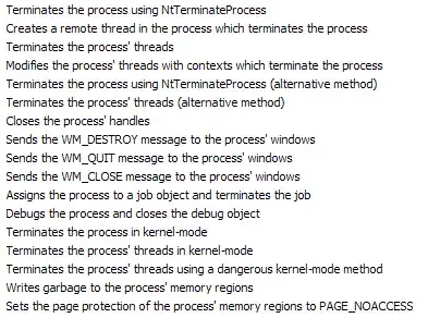

Process Hacker has a Miscellaneous → Terminator command that will try a bunch of different methods to kill your process:
failing on most attempts
full descriptions
In my tests, all this did was lock up Process Hacker and turn it into an unkillable process too, but maybe it will work in some cases.
