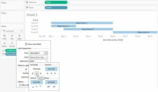

Next thing that I want to achieve is to add some text labels on top of the allocations blocks in this picture and put the "Text" of Project/Release names for each of the allocations.
I am able to do so by dragging the Project/Release names field to the "Label" category under the Marks section. This results in Project/Release names displayed next to the allocation blocks. However, to conserve space and make the plan more presentable, I want these text labels to superimpose on the allocation blocks, not after the end of the allocation blocks. Is there a way in Tableau to make it happen?

I think what you want to do here is to set the alignment on your labels to "Center".
To do this in your worksheet, you would:
  1. Click on the Label button in the Marks box
  2. Set the horizontal alignment to "Center"
