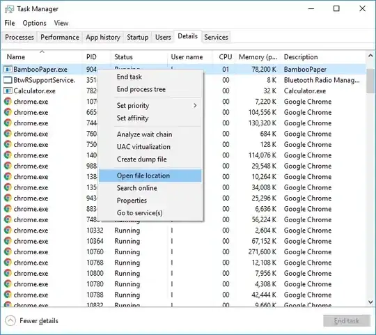

When I try Open file location by right-clicking on the process name in Task Manager:
Then encounter to permission problem (though the user is administrator):
And if I repeat the process, but from Details tab (of Task Manager):
Finally, I see a related executable file in Windows Explorer. But when try to open it directly:
