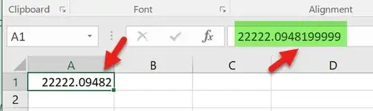

Could you please help - as I have a weird situation that when I enter a number 22222.09482 in cell then I see a different number 22222.0948199999 in the formula bar. Below is the snapshot of the problem.
Sample error
I see the same behavior when I enter the following numbers:
22222.09482
33333.09482
44444.09482
55555.09482
but when I enter 11111.09482 and 66666.09482, 77777.09482.. until 99999.09482 then they shows correctly. I am not sure is this related to rounding ? I didn't setup any rounding profiles. Could you please help me in resolving the issue.

    Neat find, does same for me - can you just use `ROUND()`? `=ROUND(A1,5)`, then copy/paste the data as Values and remove the original numbers? – BruceWayne Oct 15 '18 at 18:31
    @BruceWayne, interestingly the `ROUND()` shows the correct digits but the copy/paste as value takes it back to the original issue! – Rey Juna Oct 15 '18 at 21:11
    @ReyJuna - Then just do `ROUND(A1,5)` again on the pasted values. Then copy/paste those as values, and `Round()` again, then copy/paste. ... :P ...that's interesting, and it looks like @EugenRieck has the reasoning. Nice question! – BruceWayne Oct 15 '18 at 21:13
    Do you actually care about the difference between 22222.09482 and 22222.0948199999? It's a difference of 5 parts in 100 trillion. – Russell Borogove Oct 16 '18 at 01:35

It is a bug.
Excel uses the usual IEEE double-precision representation, according to other answers. Its precision is 53 significant binary digits, which corresponds to roughly 16 decimal digits.
It is always "safe" to display the first 15 significant decimal digits. In the sense that any decimally "presented" number given with 15 digits can be safely distinguished from the numbers obtained by changing the 15th decimal figure by one. For example, the 15-digit numbers:
22222.09481 99999
22222.09482 00000
22222.09482 00001
map to three distinct double-precision numbers. None of these three will be "neighbors" in the double-precision representation, in this particular case.
So, confusing the first two in the user display, is a bug of Excel.
In fact, in this domain (between 16384 and 32768), the absolute precision is 2-38, and the following numbers are representable:

To elaborate further, try typing 22222.09482 in one cell, and typing 22222.0948199999 (five trailing nines) in another cell. Excel should pick the two IEEE representatives indicated by the arrow above. And I think it does, because you can calculate the difference of these two cells to get 9.82254E-11. But both are shown in the same way.
If Excel had shown the first 17 digits, that would be helpful to pick out exactly what IEEE number is "underneath" the decimal number. In that case:
22222.0948199999 --> 22222.09481 99999 00
22222.09482      --> 22222.09481 99999 98
But showing 15 digits rounded in an incorrect way, is misleading and unhelpful.
Before anyone claims it is intentional, then why does 8.7 not show the same behavior? The nearest double-precision number to 8.7 is:
8.69999999999999 93
so it should show as 8.69999999999999 if this was intentional. But it does not.
    You are right, it's a bug. The algorithms for converting a binary floating point number displaying the fewest number of significant digits are hard, but known. It looks like someone missed some important detail. – Mark Ransom Oct 16 '18 at 20:53

When you enter a decimal value into your spreadsheet, it will be converted and stored in binary, and cases such as you described, will become the closest approximation that can be represented in binary. When displayed, it is converted back to decimal, again requiring an approximation, which might not convert back to exactly the same representation you entered.
Why 53 bits (give or take)? Because the typical standard for storing "double precision" floating point uses 64 bits, in which there is a mantissa (also called significand), a sign indicator, and an exponent. The exponent is usually allocated 10 bits, the sign takes one, leaving 53 for the mantissa. This is for storage. Calculations are usually done using 80 bits and rounded back.
There are situations where computers will work in base 10, especially when working with monetary values where rounding artifacts are not acceptable.
Zenilogix
  • 603
    I disagree with a blanket **All computers** statement. There were many computers, admittedly most no longer in active use except as museum pieces, that used decimal numeric formats for storage & calculations. There are also BCD - Binary Coded Decimal - used in a number of more recent CPUs, including limited usage in Intel CPUs. None of that is relevant to the question at hand - the method used by Microsoft Excel to store numbers, which is all binary. But "All computers" isn't correct. – manassehkatz-Moving 2 Codidact Oct 16 '18 at 01:15
  • I see the change from "All computers" to "Computers" - I'd go with "Almost all computers" or "Most modern computers" or something like that. I know - I'm picky. But so are computers :-) – manassehkatz-Moving 2 Codidact Oct 16 '18 at 02:19
  • @manassehkatz All digital computers are fundamentally binary. BCD is just a base-10 structure on top of binary to facilitate decimal arithmetic. – Zenilogix Oct 16 '18 at 02:33
  • While all digital computers are fundamentally binary, there actually were quite a few in the early days that were decimal based. But I agree that BCD is essentially a base-10 structure on top of binary to facilitate decimal arithmetic. – manassehkatz-Moving 2 Codidact Oct 16 '18 at 02:49
  • This answer sounds as if it's the computer's fault. But it isn't. You can represent any number precisely you could write on paper (represent 1/3 exactly? easy when storing as fraction, e.g.). It's really about what representation the Excel authors **chose** to represent numbers. – phresnel Oct 16 '18 at 08:35
  • @Zenilogix: Some early computers based on decimal arithmetic did not even use base 2 to represent each individual digit. For example, the IBM 7070 used a 2-of-5 code for error detection. – hmakholm left over Monica Oct 16 '18 at 17:35
  • @phresnel: representing numbers as fractions sounds like a terrible idea. You would have to simplify after each operation, making it very inefficient, or you would run out of space quickly. – Martin Argerami Oct 17 '18 at 13:43
  • @MartinArgerami: Implementing numbers as fractions may or may not be a terrible idea - sometimes, they are desirable. However, this wasn't the point at all. The point was that the _answer_ given by Zenilogix sounds like it's ultimately binary floating point numbers that prevent precise storage of decimal floating point numbers. This is not correct, as there is no obligation to _do_ use binary floating point numbers as an implementor. One could also use fractions, decimal floating point or even fixed point. Or something like GNU bignum. Or hybrids. Ultimately, it's the Excel developers decision – phresnel Oct 17 '18 at 14:05
Like many above have said, this is an internal representation error. Excel has made the choice for double precision, 64 bit floating point numbers. This gives you 264 possible values. The real numbers domain contains an infinity of values, so when you try to use one that cannot be represented by Excel, it will use the closest that can be represented.
I've seen comments saying that given infinite memory, any real number can be represented. True, but there is no such thing as "infinite memory" so this is a moot point. Others have stated that Excel could have used larger internal representation, for example 128 bit. True, but, it turns out that computers are better at doing mathematical operations on numbers represented with the number of bits that matches the processor's bus size. So a 32 bit computer will be fastest at mathematical operations on 32 bit numbers and a 64 bit computer will be fastest at mathematical operations on 64 bit numbers. If and when there will be a 128 bit computer, then we can expect Excel to move to 128 bit number representation. That will still provide a very large but limited set of numbers that can be represented. The same effect will still be present, just with different numbers.
If your concern is about how the numbers look in the spreadsheet, then using a set precision (number of decimals) will give you consistent results. If you concern is about the difference between the number you type and the actual number stored by Excel, you are right to be concerned. The difference is real and the error will be carried through any calculations you make. I am afraid that you are stuck with this error. This is a limitation of Excel, not a bug as some have stated. It is not likely to change any time soon, so if it is not acceptable for you, I suggest you look for another spreadsheet application that can represent numbers with higher precision. But keep in mind that should you find any such application, the limitation is still there. It's just the size of the error that is different.
