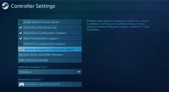

Consider a Steam Controller (or at least Steam as software managing other controler, see down below). Its rich configuration options make me think it may work for you. Please note I cannot really say how would it work for you on a basic "mechanical" level (my fingers are fine). Anyway let me point out some software options that may help.
  • Its desktop configuration lets you use the controller as a system-wide controlling device.
  • Left touchpad, right touchpad, a gyro(!) and an analog stick – any of these "subdevices" can be set up to emulate a mouse; even all of them at the same time, no restrictions.
  • Each of these "subdevices" has its independent configuration. E.g. you can make one touchpad act as a trackball with relatively high sensitivity for "global" cursor movement, the other as a mouse with low sensitivity and different acceleration for precise cursor manipulation.
  • You can make triggers (analog buttons under your index or middle fingers) act as mouse dampeners to get even more precise cursor movement. No trigger, any trigger or both triggers; independently for any touchpad or gyro. A fully pressed trigger can act as a mouse button at the same time, this can make highlighting small sections of text easy.
  • Any button (except the "Steam logo" master button, I think) can be configured to pass a keystroke or a mouse button.
    There are about 15 buttons total, including analog stick and touchpads that can be pressed (clicked), bumpers (for index fingers), fully pressed analog triggers (for index or middle fingers) and pads under the controller (for middle or ring fingers, or even little fingers, depending on how you grip); analog stick or touchpads can be configured to provide additional "buttons" (when not emulating mouse). One of the screenshots above (where you can see a controller) gives a general overview of how many buttons/axis/controls there are.
  • It's not all, there are other options (action sets, action layers, mode shifting, …). They will probably be less important for you so I skip them, the answer is commercial-like enough. When I bought my Steam Controller I thought I would admire the hardware. The hardware is OK but it turned out fast it's the software that makes the controller great.
  • There are options to allow Steam manage other controllers.
    I have tested Steam with Xbox compatible pad, its analog sticks can be used to emulate mouse as well (although in this mode dampening with triggers seems to be unavailable, be warned). Maybe a large arcade controller will fit you better. Note I don't know whether you can use these controller options of Steam without Steam Controller or you must register some Steam Controller to enable them (even if you intend to use another controller only). If you have any controller, install Steam and investigate.
Other information:
  • Steam Controller is intended to be held with both hands, you may consider this a disadvantage. Still I can imagine two different ways for operating with one hand only:
    1. You hold it with one hand and use just one half of the controller. In this case mouse dampening with a trigger will be useful.
    2. You place the controller flat on your desk. Two touchpads, analog stick (with possibly different sensitivity and acceleration settings for mouse emulation) and few buttons are available. It's possible to configure e.g. A and B buttons as two mouse buttons, X and Y as the same mouse buttons in toggle mode (press once and the mouse button sticks; press again and it gets released). This way you can emulate mouse even with just one finger.
    You can even have two action sets to cover both operation modes (and maybe a third set for two hands) and switch between them.
  • My screenshots are from Kubuntu. I believe the same functionality is available under Windows. Knowing that Steam is a platform for video games and most games (and gamers) use Windows, I expect the functionality in Windows is at least as good.
  • When configuring the controller itself (moving around these blueish config screens), it behaves like a gamepad, i.e. your previous configuration (e.g. mouse emulation) temporarily doesn't count. This may be an obstacle in your case, that's why I mention it; but once the controller is configured for good, the problem is no more.
  • Steam client acts like a driver, it needs to run. I'm not sure you need to have a Steam account (but even if you do, it's free). I'm sure the controller works regardless if your Steam is in online or offline mode. You don't need to buy any game to use the controller for desktop.
  • Steam Controller can be used as wired (USB) or wireless device (dedicated USB dongle included, Bluetooth Low Energy supported).
Disclaimer: I have no connection with Steam or Valve other than being a (rather casual) gamer who uses Steam and Steam Controller.
