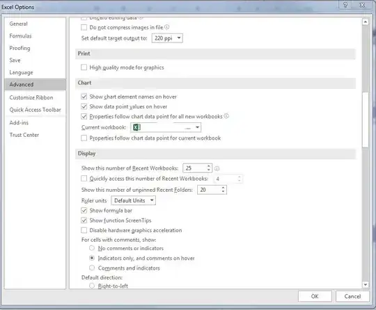

  • I have already unchecked Properties Follow Chart Data Point for Current Workbook.
