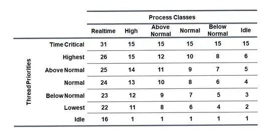

So in perf mon I can attach a base priority counter to a process such as google chrome. This shows its priority as "8". If i look in task manager google chrome have "normal priority".
My question is, does any table exists that show that a 8 in perf mon is the same as normal priority?

This table used to be fairly easy to find at microsoft.com and countless other places.
The "Base priority" column in Task Manager is showing you the process class (called "process priority class" in some docs). Note that Task Manager (at least in Windows 10) labels the "Idle" priority class as "Low" (probably to avoid confusion with the idle process, etc.).
The process class is used only to initialize the priority of threads created within the process. Every thread is created with the "normal" thread priority. If the process is of the "normal" process class, then that means the thread has a base priority of 8.
(Oddly, the CreateProcess API takes an argument for the process class, but CreateThread does not. To create a thread with other than the "normal" thread priority, you have to create the thread and then change its priority later with SetThreadPriority.)
Programs can change the priorities of their own threads within their process class. In a "normal" process, setting a thread to THREAD_PRIORITY_HIGHEST sets that thread's base priority to 10. If you change the priority class of a process (say with Task Manager) then every thread's base priority changes according to the table.

You'll notice that there is no "0" on the table. Ordinary applications cannot request running at priority 0 through the normal APIs. Only kernel mode threads can run at priority zero. As you've found, that is reserved for the zero page thread - or threads; there may be more than one on a NUMA machine.
Regarding the idle process - it and its threads are special cases. Every thread object has a "priority" member, and for the idle threads these are set to 0. However the idle threads' priority members are never actually used for anything, and there is no ready queue for the idle threads. Instead, if the OS scheduler can't find any other thread to run on an available CPU, it simply picks the idle thread for that CPU. (Every CPU has its own dedicated idle thread.) So although it seems to have priority 0, it's scheduled as if it had priority negative 1. Even a priority 0 thread will take precedence over the idle thread.

There are 32 priority levels in Windows, from 0 to 31.
They are grouped as follows:
  • 31 — 16 are real time levels
  • 15 — 1 are dynamic levels
  • 0 is a system level reserved for the zero-page thread
When a process is created, it is assigned one of the six priority classes:
  • Real time class (value 24),
  • High class (value 13),
  • Above normal class (value 10),
  • Normal class (value 8),
  • Below normal class (value 6),
  • or Idle class (value 4).
The priority 8 that you observed is the "normal" priority. The priority 0 is the lowest priority possible, so the process will never be executed as long as a higher-priority process or thread exists.
