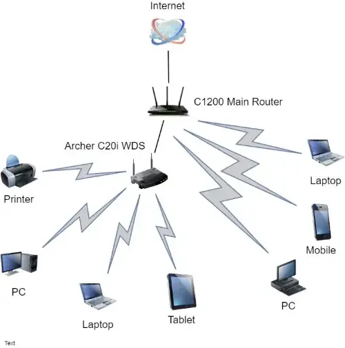

Network diagram:

  • Please add to your post a schema of the network, plus info such as DHCP server and IP addresses. – harrymc Nov 16 '18 at 12:09
  • Network diagram updated in the main post. DHCP enabled on the main C1200 with an IP of 12.37.65.43 DHCP Range: 12.37.65.78-90 Channel Auto On the WDS AP (Archer C20i): the MAC of the C1200 is entered/captured connected to the main network of the C1200 through site survey. WDS is selected IP Address is 12.37.65.99 DHCP is disabled. SSID set to match the original networks, Channel is set to 11. – JAckBlack854 Nov 17 '18 at 08:10
  • How is the WDS connected to the router, is it [LAN to LAN](https://superuser.com/a/936639/8672)? – harrymc Nov 17 '18 at 11:28
  • It's over wireless. – JAckBlack854 Nov 18 '18 at 11:47
