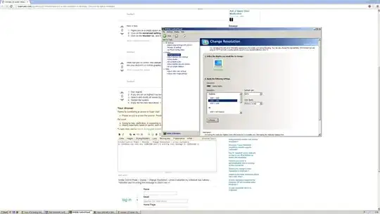

So the solution is fairly straight-forward: Open the Format Picture task pane, navigate to the 3-D Format section and click the "Reset" button. And -POOF- the problem disappears.enter image description here
