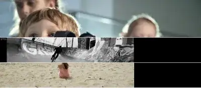

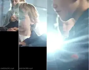

You can do this with mpv if you don't mind using the command-line:
3 videos side-by-side (stacked horizontally)
mpv --lavfi-complex="[vid1][vid2][vid3]hstack=inputs=3[vo];[aid1][aid2][aid3]amix=inputs=3[ao]" input1.mkv --external-files="input2.mkv;input3.mkv"
2 videos
mpv --lavfi-complex="[vid1][vid2]hstack[vo];[aid1][aid2]amix[ao]" input1.mkv --external-file=input2.mkv
Notes
  • In Windows use ; to separate each file name in --external-files (as shown in the 3 videos example). In Linux and macOS use :. Alternatively, use two instances of --external-file instead such as: --external-file=input2.mkv --external-file=input3.mkv.
  • Files must all be the same height. If they are not then add the scale, pad, and/or crop filters. See the mpv documentation and FFmpeg Filters for more info.

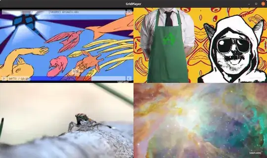

GridPlayer can play any number of videos simultaneously. You can play, stop, seek all of them or each video separately. You can set loops. You can also control playback rate, sound volume, zoo, etc.
Full disclosure: I am the author :)
vzhd1701
  • 116
    I know this is a very late answer so it doesn't have much upvotes, but this really needs to be more visible. Tried it out, it's the least hassle way to do it. I know of Awesome Video Player, but this one is free and open-source. Depending on your machine, you may get some framerate hiccups if you're playing too many full HD videos at once, but that's about the only limitation I can see. – Anomalous Underdog Nov 27 '21 at 13:13
  • I have used Gridplayer on an Intel Mac and it was awesome. On an M1 Mac, opening fails with a notice that Gridplayer is damaged and should be put in the bin. Downloaded twice. Not a security issue as I right-clicked on Gridplayer to open it and have an exception. Too bad! – Foliovision Feb 06 '22 at 21:54
  • @Foliovision Have you tried the [workaround](https://github.com/vzhd1701/gridplayer#macos-gridplayer-is-damaged-and-cant-be-opened)? – vzhd1701 Feb 08 '22 at 06:08
  • Thanks @vzhd1701 This exact command did work to make Gridplayer open. There's still long spinning beachballs waiting for Gridplayer to finish opening. I'm also having an issue with video rotation (my upside down videos are playing sideways) but that's probably not related to the M1 issues – there don't seem to be any rotation controls even if there are aspect ratio controls. – Foliovision Feb 16 '22 at 15:20
  • Definitely recommend this application, it works exactly how I wanted it to. I did a bunch of video transcoding and wanted to play the videos side by side to see if there was any noticeable quality drop, this was exactly what I needed and would recommend it for anyone with the same issue. – 97WaterPolo Jan 04 '23 at 22:44

When comparing video quality, it helps to have the videos split, so that you can see the difference in pixel quality.
  1. Vivict offered a great way to compare videos split in this manner, especially because of how you can use the mouse to move the splitter line. However, the project is limited to two simultaneous videos and it doesn't support some formats.
  2. ffplay can be used to place videos side by side.
  3. Since the above two had limitations, I wrote a program which allows you to add as many videos as you like, and has options to change the axis and video positions. See the splitVideoQualityViewer project.
