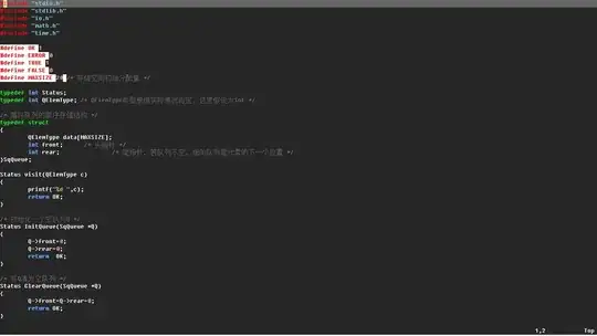

If you want vim to achieve full screen in Windows thoroughly (like in the picture), the plugin gvimfullscreen_win32 is highly recommended.
The plugin allows easier access to a full-screen mode and distraction-free environment. You can also add :set go= to gain more space. Here is a screenshot (Gvim7.4 on Windows 8.1):
