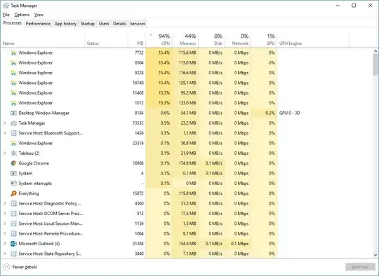

I'm at a loss as to why my Windows 10 laptop is consuming so much CPU from explorer.exe instances. I've attached two screenshots showing five explorer instances using about 15% CPU each. I have absolutely no idea what they are doing and if I kill them, nothing happens.
The explorer instances are not always there consuming tons of CPU. I haven't been able to really determine a pattern as to when they start consuming all the CPU. The thing that triggers me to look is when my fan kicks in. Once the cooling fan kicks in I know that the CPU is getting railed by these explorer instances. I'm not sure where to go look for information pertaining to these processes and what resources they might be accessing that causes this.
My CPU usage will go up to 95% with these processes and I'm trying to figure what could be causing it.
