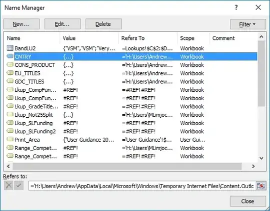

Check Name manager - name does not exist: Check Name manager - name does not exist

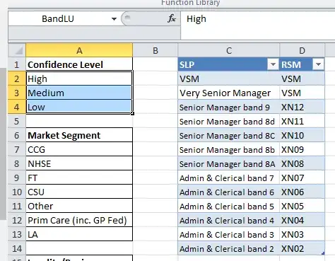

Name a range with the same name and it works fine: Name a range with the same name and it works fine

  • What happens if you try the same renaming in name manager? Can you post some screenshots? – Máté Juhász Feb 19 '19 at 07:20
  • Same issue if renamed in Name Manager - added images to original post (not sure if you can add them to comments!) If I format the tabler as a range and name that BandLU it works fine - this is a workaround I've had to use for this but it removes the ability of making the list dynamic for lookups without VBA – Marcus Black Feb 19 '19 at 13:47
