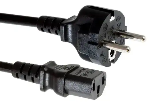

Referring to this type of power cords that either attach directly to the PSU, or to a power adapter that powers the monitor or laptop.
Is there anything to watch out for when swapping these cords, or do we only care about the adapter voltage/current requirements?

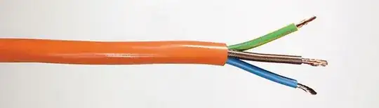

Conductor Gauge
This is the diameter of the conductive wire inside the cable – see American Wire Gauge / AWG for a common measurement.
A thicker cable can carry more current, but costs more and is less flexible.
An important factor is voltage drop due to resistance, and the potentially dangerous side effect of internal heating which can lead to melting the insulators, fire, death, etc.
Conductor Material
Copper is a relatively good conductor of electricity (low resistance per distance), it's flexible, abundant, etc... This makes it quite suitable for use in cables. However, due to the demand for copper, it has become more expensive, and alternatives have appeared – in particular "copper coated aluminium". Aluminium being a worse conductor of electricity than copper (for a given cross section – higher resistance per distance, approx 61% as good) raises the potential for internal heating, melting, fire, death, etc.
Strand Count
More strands of finer conductors can make the cable more flexible... which is pleasing to handle – but this can also cause problems and reduces the cable's ability to carry current.
This can also play into internal heating, melting, death, etc.
