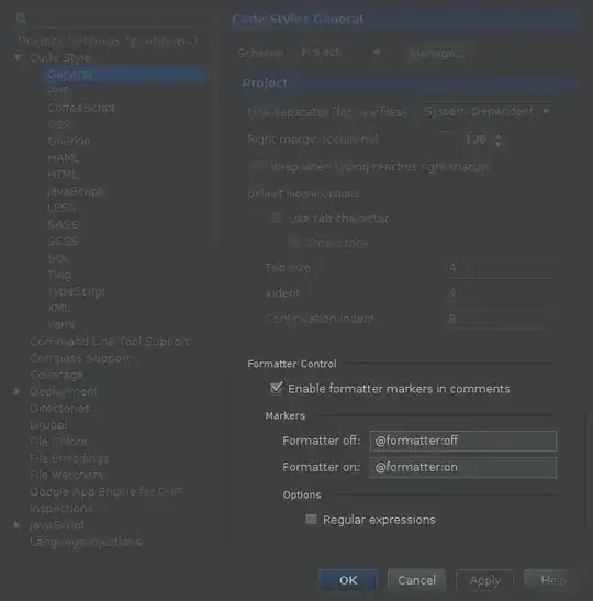

The only option for such a case that is provided with Okular is when files are opened in new tabs. When this is enabled, the option to "switch to the tab if the file is already open" can then be used to have the desired effect. The relevant option is highlighted in the screenshot below:
okular_settings_switch_to_existing_tab
