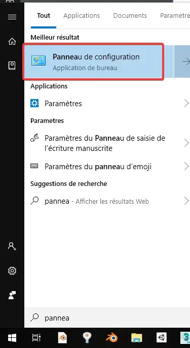

  1. Open the Control Panel (for that you can type it in your start menu) : open control panel
