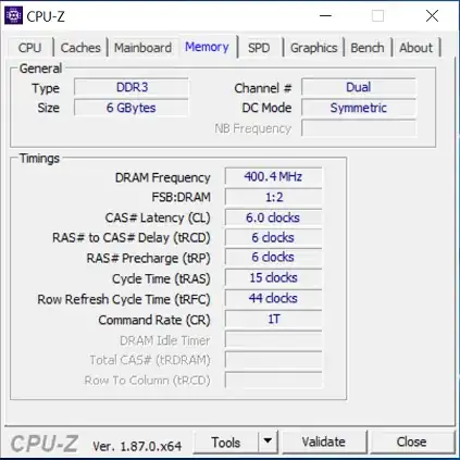

  • WOW, thanks to both of you since I now recall reading about RANK and CPU-Z some 3-4 years ago. Totally forgot about it. Well, I just checked the memory tab and in BOTH the original configuration and the one where the config is now, with like modules in the same color and they both say Dual. That doesn't make any sense because like I stated above, one of those configs is going to have 4GB on one channel and 2GB on another I would imagine. Unless that is what FLEX does. I haven't found enough documentation about how FLEX works on the G43 chipset. – Rich Manson Mar 15 '19 at 07:49

Both the original memory configuration and the current one showed the DIMMs in both the BIOS and CPU-Z as reporting the memory running in 'Dual' mode. Notice the images below.
Original Memory Configuration with 4GB in channel 'A' and 2GB in channel 'B'
CPU-Z Memory Tab Showing Dual Channel with 4GB in channel 'A' and 2GB in channel 'B'
Current Memory Configuration with 3GB in each channel 'A' and 'B'
CPU-Z memory Tab Showing Dual Channel

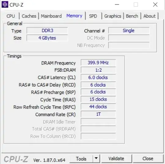

CPU-Z Showing single channel with just the first pair of DIMMs populated
CPU-Z showing single channel with 1 pair of modules in 1 Group of DIMMs
