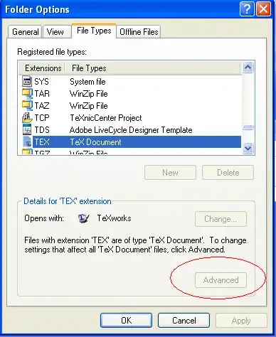

Edit: OK, so this won't change your icon. The solution will depend on which version of windows you are using. For Windows Vista and Windows 7 have a look at this. For Windows XP, I think the following will do:
  1. Go to your control panel
  2. Choose "folder options"
  3. In the tab "file types" find the extension .tex, then choose advanced (and you might want to do the same for other file types associated with latex)
alt text
I don't have administrator rights, so I don't know what exactly is there, but I believe you might be able to find what you want!
