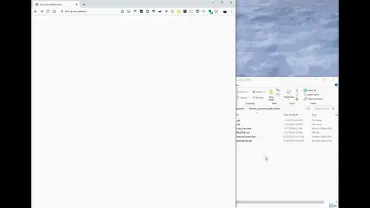

Update 9/5/2021: This answer and the script have been updated. Now it works again with the new Chrome "Session_" and "Tabs_" files.
Don't restart Chrome again yet (hopefully you're seeing this from another browser). There's a chance that the files mentioned below will be overwritten when Chrome gets restarted, so try to make a copy of them before that happens if possible.
If you go into your Chrome User Data directory, you should find the files Session_* and Tabs_*, which are files for your Session. There should be files for both your Current and your Previous sessions.
- on Windows:
%USERPROFILE%\AppData\Local\Google\Chrome\User Data\Default\Sessions\if you're using the Default Chrome Profile. - If you have multiple Chrome Profiles, the other profiles can also be found in the User Data directory, with names Profile 1, Profile 2, etc. Each profile has its own
Session_andTabs_files. - If you can't find the directory, see here
Copy these files to another location as a backup before you restart the browser so you don't lose them if they get accidentally replaced with an empty new session.
Now, if you kill your browser and then relaunch it, it should ask you if you want to restore your session, and it will pick the newest pair of Session_ and Tabs_ files from that directory. So you should be able to remove the newest pair from there and leave the older pair to open that session when you restore.
For this, you need to Kill the browser, not just close it, because otherwise, it won't trigger the "Restore session" prompt.
To Kill Chrome:
- You can enter
chrome://inducebrowsercrashforrealzin the URL bar, or use Task Manager, or the command line, or (in Windows) runtskill chromestraight from theRundialog window which can be opened withWinKey + R
So in summary, after grabbing the right files, the steps should be:
- Kill Chrome
- Put the right files in the directory
- Relaunch and click "Restore" when prompted
I also wrote some simple bat scripts that I use to easily copy the current session files, restore, and make some backups.
You can check them out here:
https://github.com/aljgom/chrome_sessions
(this demo video is slightly different than the updated version, but it is pretty much the same)
